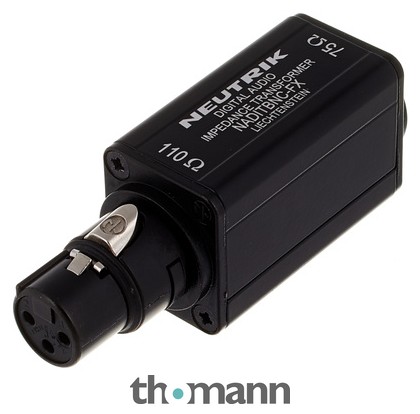

                      Online vond ik volgende kabel:
                      Digital Interface Cables Length: 3 m, XLR female -> RCA male, Suitable for all RME Fireface Cards, 110 Ω, Colour: Black, Made in Germany
                      Zal dit perfect werken of gebruik best het volgende:
                      AES/EBU BNC Adapter Female Cable End XLR 110 Ohm to Female BNC 75 Ohm
                      en
                      S/PDIF Interface Cable Length: 2 m, Colour: Black, Conical, gold-plated RCA connector
                      Comment
